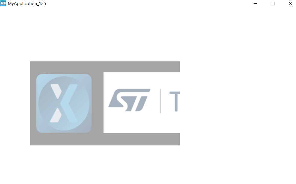

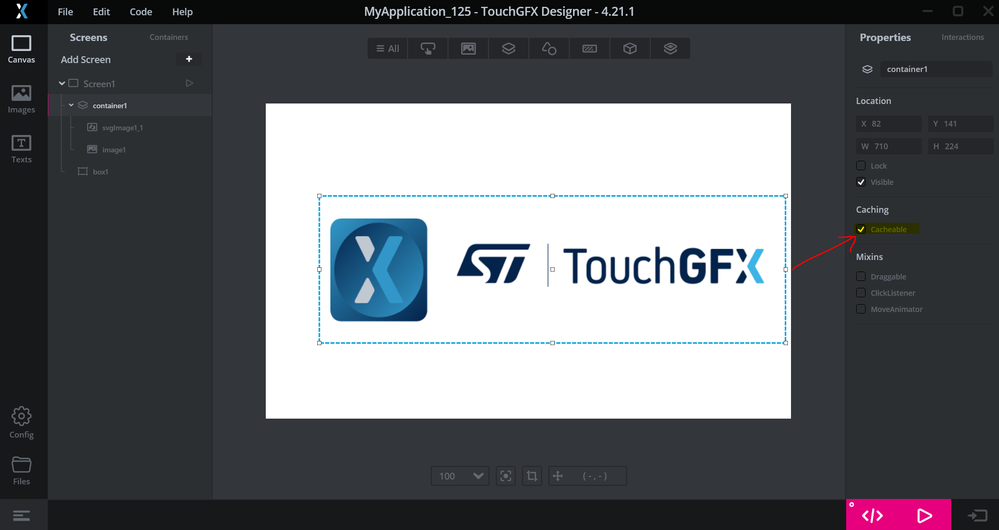

Hi MM..1,
Yes, it doesn't show the fade choice, it's usable with code:
In .hpp :
class Screen1View : public Screen1ViewBase
protected:
uint32_t sdramBuffer[800*480*24/8];
uint16_t* sdram = (uint16_t*)sdramBuffer;
};In .cpp :
Bitmap::setCache(sdram, 400*480*24/8, 2);
Bitmap dynamicBitmap1 = Bitmap::dynamicBitmapCreate(400, 400, Bitmap::RGB888);
container1.setCacheBitmap(dynamicBitmap1);
container1.enableCachedMode(true);
container1.updateCache();
container1.setAlpha(90);
container1.invalidateContent();
/Osman
2023-02-06 9:17 AM
Yes thanks, i need fade in image , then more lines not simple ...
On handling this i have sugestion, add fade in screen option over LTDC alpha ...
