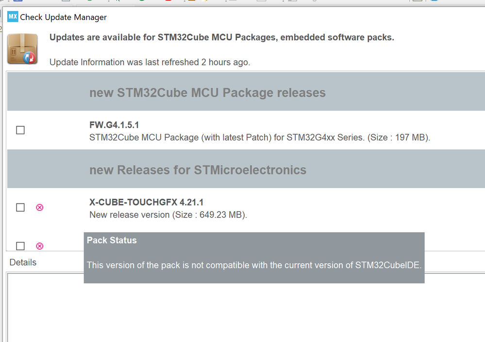

Nice but is compatible with 1.11 IDE ? My 1.10.1 say no
2023-01-23 6:30 AM
Hello MM..1,
Can you send us a screenshot of the message you have on STM32CubeIDE please?
/Osman

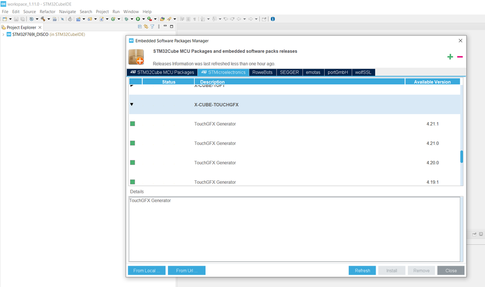

Ok, that's strange, I don't have this warning on my side with STM32CubeIDE 1.11.0.
Can you try to install the Package from STM32CubeMX directly instead, and not from the STM32CubeIDE interface?
Also maybe click on "Check for Updates" under the Help menu.
/Osman
2023-01-23 9:33 AM
Maybe you misread my message i have 1.10.1
and update test say no new IDE exist.
But soft package as on image.
And your last image is answer yes 1.11 is compatible ...
