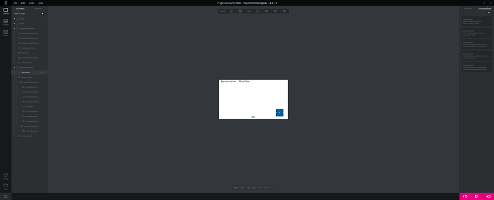

Hello. I use a SwipeContainer with 2 pages. I have a button with which I want to switch to another page. But the simulator and also the STM32F7508 crashes. Does anyone have an idea to solve this problem?

The GUI works fine, also the SwipeContainer. But when i want to change to another screen with a button, the simulator and also the STM32F7508 crashes.
The Screen with the SwipeContainer has 2 pages. Everey Page includes a custom container with a ScrollableContainer and a ListLayout. I included the relevant files, because the project has approximately 1GB.
