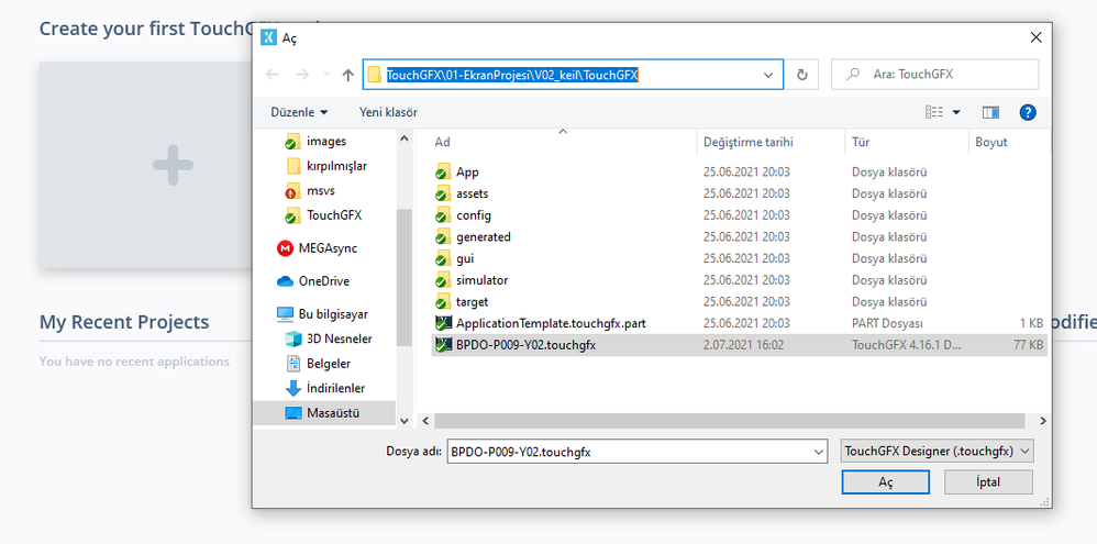

In addition, I can't create a new project and got this error
2021-07-05 4:02 AM
Hi, I installed TouchGFXDesigner 4.17.0 and when I try to create a new project I always got error. I want to try cacheable container feature which mentioned at this link: https://support.touchgfx.com/docs/development/ui-development/scenarios/achieving-better-performance-with-cacheable-container .
I have another problem about D-cache. If I have disabled D-cache, the informations on the TFT screen which I have created via TouchGFX Designer 4.16.1 are always true but sometimes software goes hard fault. If I have enabled D-cache software running is good but this time screens getting stuck.
2021-07-05 4:07 AM
That second issue should be linked to your internet connection. Open a browser like Chrome and give it another try.
/Romain
2021-07-05 4:10 AM
My connection is alright and I'm still getting the same error.
2021-07-05 4:11 AM
What error do you face when you try to create a project ? Could you share a screenshot ?
The D-cache is a known issue but should have been fixed with TouchGFX 4.17 I believe. What mcu are you working with ? Did you use a TouchGFX Board setup (new name for Application Template) or a custom project ? Have you tried debugging to see where the screen gets stuck ?
/Romain
2021-07-05 4:20 AM
Do you also face it if you try to create a project with another UI (go to the Examples tab) ? Your connection might be alright but did you still try to open an internet browser (needed for TouchGFX to connect to the server) ?
/Romain
2021-07-05 4:25 AM
On your initial project facing the "Object reference not set to an instance of an object." error, can you try to open up the excel sheet found in the <project name>/TouchGFX/assets/text folder ? Or is it corrupted ?
