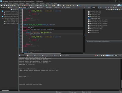

I am currently facing challenges with initializing WiFi on the STM32H7B3I-DK board following the clock and weather example provided by STMicroelectronics. The main issue arises when attempting to initialize WiFi WIFI_Init() before starting the FreeRTOS kernel (`osKernelStart()`). This results in the program getting stuck in an infinite loop, possibly due to a semaphore-related function `wait_spi_tx_event()` defined in the `net_conf_es_wifi_spi` file. Furthermore, when trying to initialize WiFi within a task, I encounter `NET_ERROR_NO_MEMORY` errors during memory allocation (`malloc()`), even after increasing the heap size.
Problem Analysis:
1. Infinite Loop Issue: The program gets stuck in an infinite loop, likely due to WiFi initialization occurring before starting the TouchGFX task. This situation leads to problems with the semaphore related to SPI transmission (`spi_tx_sem`), which is referenced in the `wait_spi_tx_event()` function.
The SEM_WAIT is Defined in the DedicatedBufferVideoController File as shown.

Yes I understand but what I found in the Clock and Wheather example that there is no DedicatedBufferVideoController file where the SEM_WAIT is defined, In Addition the latter have Initialized the WIFI before the kernelStart I suppose.
