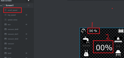

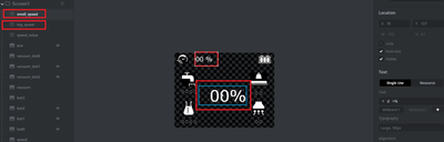

I use STM32L431 to build a mainboard and LCD display, then develop the UI with touchGFX; From the button of mainboard to triggle and transfer to screw1.cpp, the number of textArea(picture:red 1 ) can increase when i press the buttom of mainboard, but number of textArea(picture:red2) can't any change and just display 00% with initial value; what was more, with the same code for the function of decrease, the function is ok that the number of textArea(picture :red2) can be visable and decrease when i pressed the buttom;
remark: increased and decreased number of center textArea is devided into 2 textAreas;
the function is fail and the top textArea is ok , but center textArea can't any change if pressed buttom, just list the initial value 0%

Have you set the text number 2 correctly ? With the wildcard buffer ?
