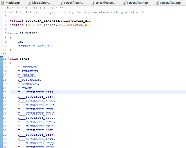

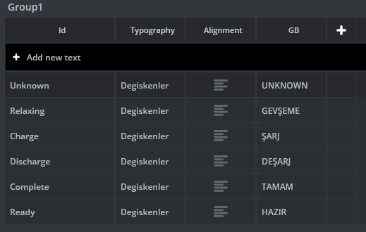

Hi Guys.
I want to set textarea. I created the new texts.
And program is here;

}BT4_Status_Value_Text buffer is 25 byte. When I compile the program it doesn't give any errors. But when I load, program is doesn't work.TFT screen and other hardwares (canbus, status led etc.) is not working. If I assign any text id directly to "bat4TextId" the program runs and I see the text I assigned on the screen.
void screenView::updateStatusText4(touchgfx::TypedTextId bat4TextId)
bat4TextId = T_CHARGE;
Unicode::snprintf(BT4_Status_Value_TextBuffer, BT4_STATUS_VALUE_TEXT_SIZE, "%s", touchgfx::TypedText(bat4TextId).getText());
BT4_Status_Value_Text.invalidate();
}All text ids are defined in TextKeysAndLanguages.hpp.
I think I can't link the Bat4TextId with the bat4TextId in presenter. What's the problem?
