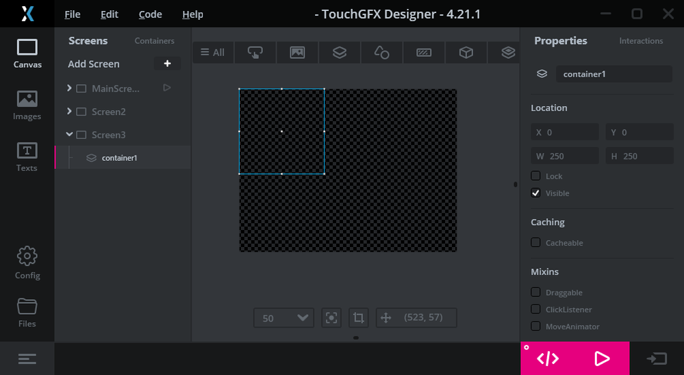

When creating a 'screen', (0,0) position of screen and container are at the same position

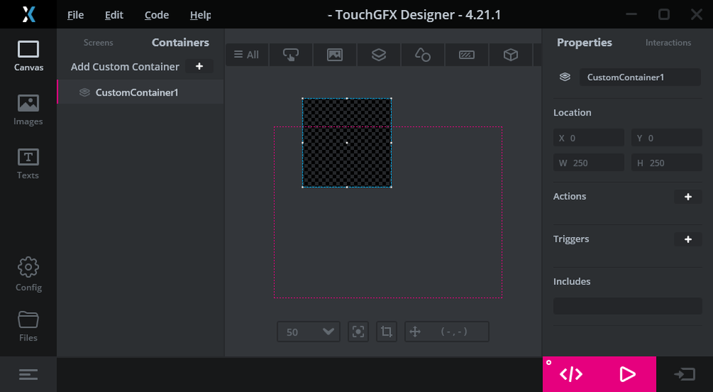

However, in 'custom container', screen and container are missplaced - as if container was expecting screen in portrait orientation but the project is set to landscape.
Thanks
2023-01-23 7:37 PM
That seems like a bug, i will report it. But this wont have any impact in your development as the screen "shadow" you see in the Custom Container*s setting tab does not have an impact on its development as they are not linked. Its initial position will be set once you add it in one of your screens.

2023-01-24 11:54 AM
Hi
'the screen "shadow"' - great, new entry into GFX glossary
"this wont have any impact in your development"
That is good. I tried to export and import container and without problem.
BTW, why do you prefix your name(s) with a forward slash ?
Thanks
2023-01-24 9:58 PM
no reason actually, just a habit :grinning_face_with_sweat:
