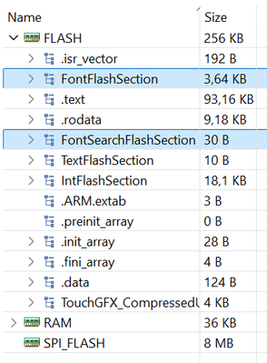

And my linker result is like below:
As you can see there is still %55 empty on my internal FLASH and very little SPI_FLASH is used, I would like to use only internal memory. Why this 13388B is not used on FLASH, even I force to use internal flash section on touchGFX settings.

I realized that that, the data on SPI_FLASH is the font. There is no option on touchGFX or somehow I cannot see that, I cannot force to put the font data on internal memory,
I think only data on external FLASH is the font, I`ve changed my font size to be sure, and realized the used memory is decreased..

Thanks for the fix, it resolved the issue, now there is no data on the SPI_FLASH as I requested, but this time, I cannot print any text on the display regardless of the font, size, type etc.
Do you know is there any root cause might cause font cannot be displayed?
Edit: Under the text configuration config window, the "Mapped storage format option" must be selected, so with this selection resolved my issue.
