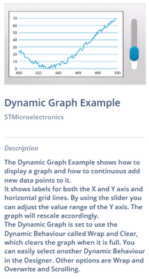

Have you tried the graph widget?

Ok and what about my suggestion using the graph widget? Have you tried that? If you need help to get started, we have a example in the designer which you could get inspiration from.

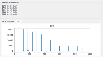

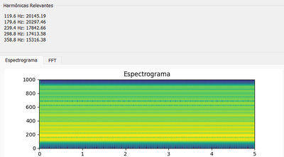

I need a spectrogram; I made a simulator with Python. The first image below shows the spectrogram I'm trying to create in touchgfx, while the second image, which is the FFT, I can do without problems.
Image 1:
carlosdelfino_0-1770670630577.png'
Image 2:

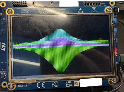

I am able to do this on m STM32N6570-DK board :
It is made of 800 x 3 = 2400 points , and  render time is around 6ms.
I'm using VectorRenderer class to draw this. Let me know if you want me to share my project with you.

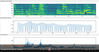

The graph I need is a Spectral graph, which has 3 dimensions: Time (x), Frequency (y), and magnitude (colors). As in the image below, the first is spectral, the second is Mel Band obtained from Cepstral, and the third is FFT:
VectorRender comes very close, but an expert wouldn't have immediate insight into what's being represented.
I'll study VectorRender because it could be valuable in another case.
