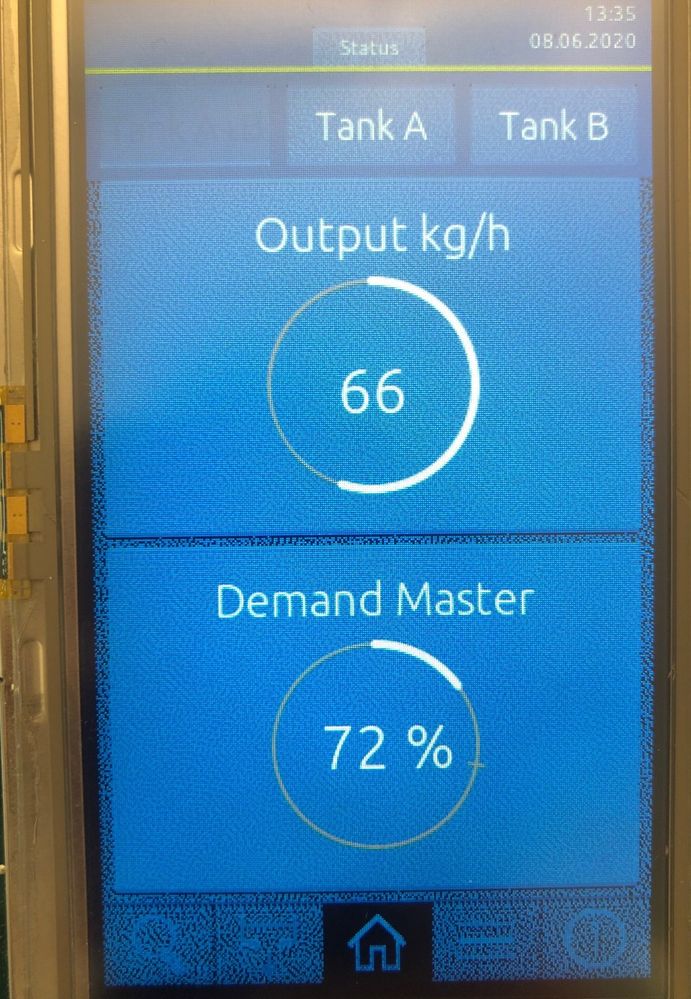

Hi @Martin KJELDSEN
I gave it a try: When working with 16bit RGB565 and ARGB8888 (non opaque) the chromartdma is working fine.
But when using it with L8_RGB565 and L8_ARGB8888 something is going wrong. (See attached pictures)
Any ideas, hints?

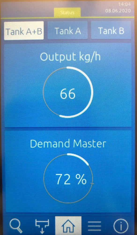

This is what it should look like
Thanks, /jimmii

2020-06-08 11:45 PM
Text Color seems ok, but the "Home" Button is wrong (color) and if you zoom in there are arifacts throughout the whole screen.
Just to make sure, the top image is with L8 and the bottom without L8. This happens when using "your" ChromArtDMA Class file.
When I'm using the "normal" DMA Class file, both image formats work fine, but with the L8-version which takes longer to animate (which is understandable)

2020-06-09 11:57 PM
Thanks @scottSD
I did, but the only thing it changed was the look of the artifacts.
