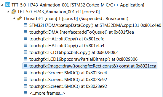

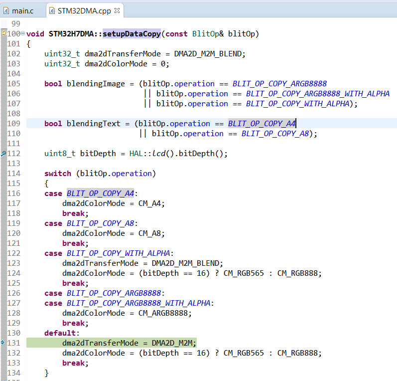

My guess is that your ChromART/DMA2D class doesn't support L8. Break inside setupDataCopy() to figure out if it's getting called for the image being moved.
2020-05-20 6:24 AM
It appears that it is.....
Debug callstack,

As I stated in the post description. When the image is formatted as an L8, the animation onto the screen is very choppy.
I don't see where the CLUT is even referenced in STM32H7DMA, so i am wondering if it does support L8.
Is there anyway you can test this out yourself?
