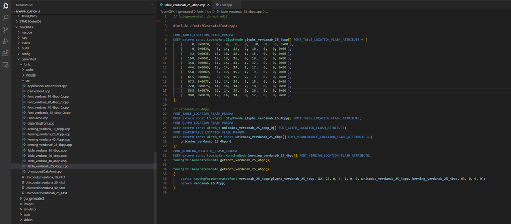

But, if you really want to modify the spacing of this particular font, you have to open the font.cpp file related to your font and modify it for each character of your text.

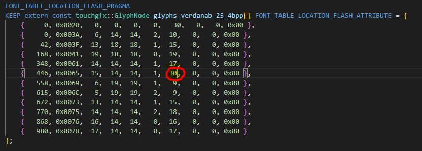

For example, that is the .cpp file of my verdana_25_4bpp font :
The spacing (called "advance" in TouchGFX variables) is the 7th element of the glyphs list.
So, if I want to modify the spacing of the 6th glyph here, I can increase the 7th element value (here from 17 to 30 for example) :
