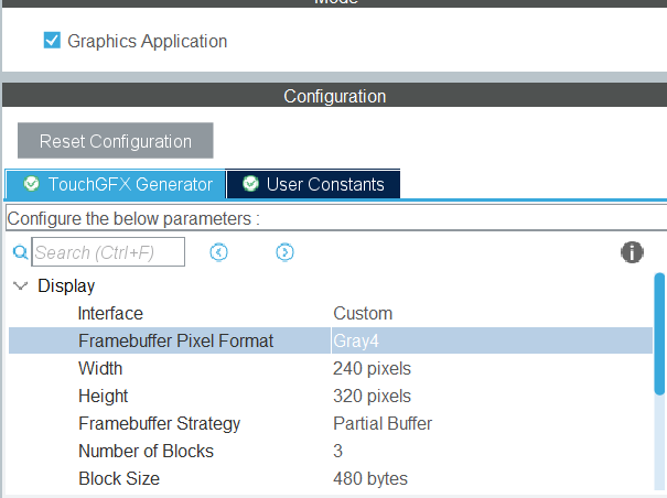

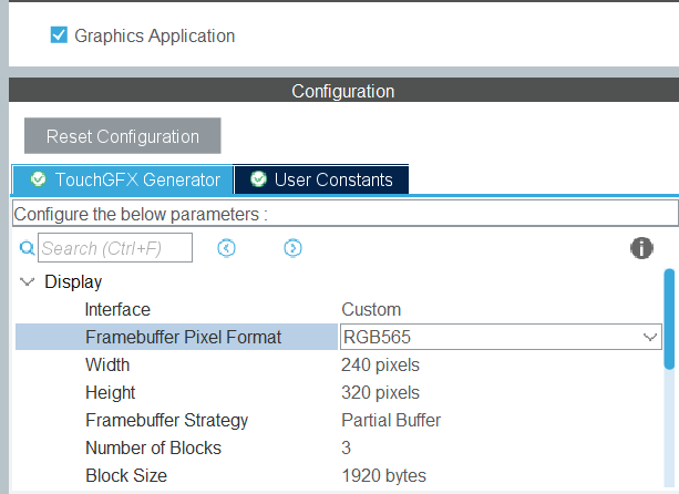

I have integrated ILI9341 SPI display to Touch GFX. Frame Buffer Pixel Format is - RGB565 and getting the output. But when I change Frame Buffer Pixel Format from RGB565 to GRAY4 not getting the output.
(Actually ILI9341 Supports RGB565). Is this possible to print GRAY4 images on RGB565 ILI9341 display?
Frame Buffer Pixel Format : RGB565
Frame Buffer Pixel Format : GRAY4

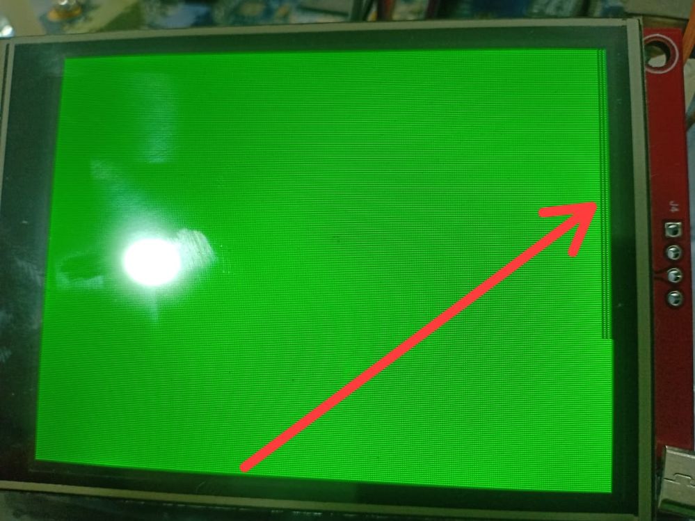

2022-09-29 5:35 AM
@Yoann KLEIN
It shows only 3 vertical lines.

TouchGFX dont mangle framebuffer format to other format for hw LCD. You need rewrite your custom code for partial buffer sending .
