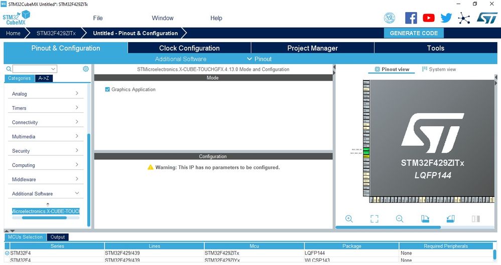

When i enable STM32-XCUBE-TOUCHGFX pack in my cubeMX software ; i have no parameter to configure but i got this warning : "This IP has no parameter to be configured" .
How should i solve this issue?

I think CubeMX is just letting you know there are no user-configurable parameters for that option. It's informational and not something that should cause problems generating or running code.

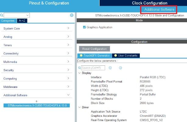

Normally, I should see something like this in configuration window :

Hello @FKafi.1 ,
This's a new behavior you mean ? using which CubeMX version your latest screenshot ?
