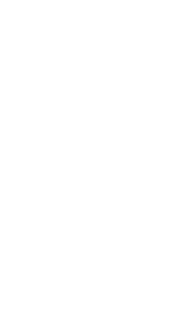

When I run simulator of video sample with Display Orientation, the video is rotated.
Jpeg picture with LIBJPEG is also rotated.
Could you please advice me?

Apparently the Video widget in portrait mode is not implemented yet. It is "expensive" to rotate the decoded image when putting it in the framebuffer.
/Romain

I do not know how to do this myself. It is still under discussion on if it should be implemented for TouchGFX 19 or for a later version.
What I can only recommend for now is to change your project settings within STM32CubeMX to invert the size and width of the display to change the display orientation there instead of through TouchGFX Designer.
