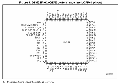

Okay, I think I can understand. Here is the one figure showing pin names and the chip. Pin 1 is top-left. This is very close to the CubeMX presentation, except the pin 1 marking isn't shown.

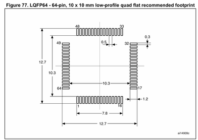

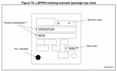

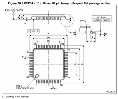

But then here are 3 others from the same datasheet. Pin 1 is bottom-left in all of these.
