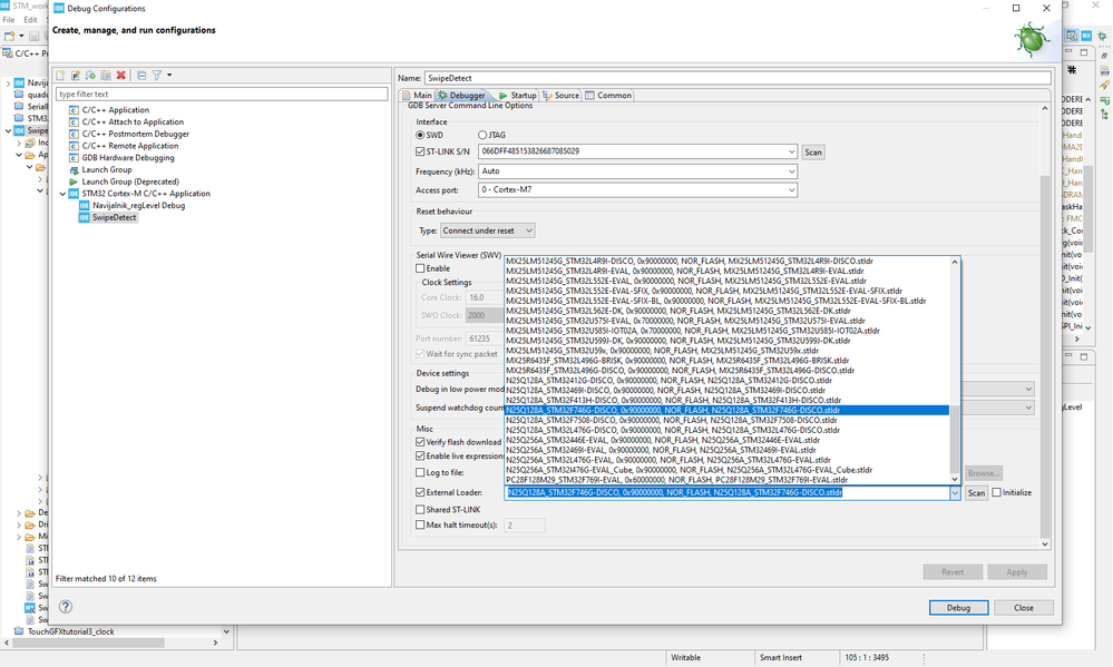

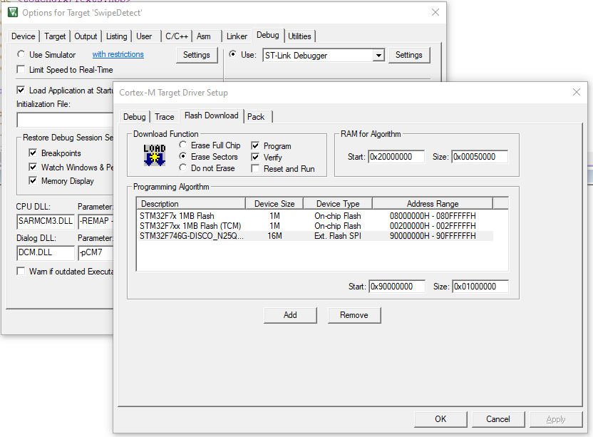

Hi, had a same problem, took me hours to fix it. The reason is that some content (image and text is to be placed on external flash). To load onto external flash you need an external loader. CubeIDE, CubeProgrammer or Keil uVision are neither aware of that and you need to set it up manually, while TouchGFX Designer is apparently correctly setup to use external loader.
Keil uVision: Project Options -> Debug -> Use: ST-Link debugger -> settings -> flash download -> ADD -> find flash loader for your evaluation board or create your own loader -> set RAM size to 0x00050000, leave RAM adress unchanged.STM32CubeIDE:
Debug Configurations -> Debugger -> Scroll down and tick External loader -> Scan -> find appropriate loader for your eval board.

@Martin KJELDSEN I think you should sincerely consider adding this note to Compiling and Flashing section of documentation, because it kind of prevents you from developing an application, as you cannot flash and debug from IDE. It took me hours to figure out the cause and not everyone is as stubborn as me :D
