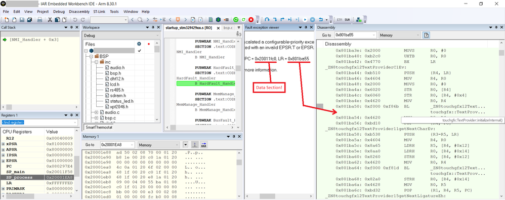

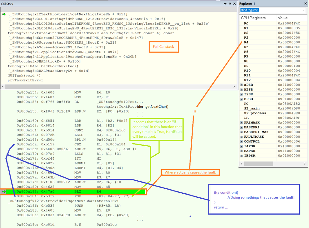

By tracking `LR` and `PC`, I find out that HardFault occures in `TextProvider` class.
I think stack corrupted. Due to often times, `PC` is in the `DataSection`.
I increased the stack size of my GUI task and `configTOTAL_HEAP_SIZE` of FreeRTOS configuration, But results not changed. Is there any other stack size ( or heap size ) limitation?

Generated text in the region of internal flash memory :

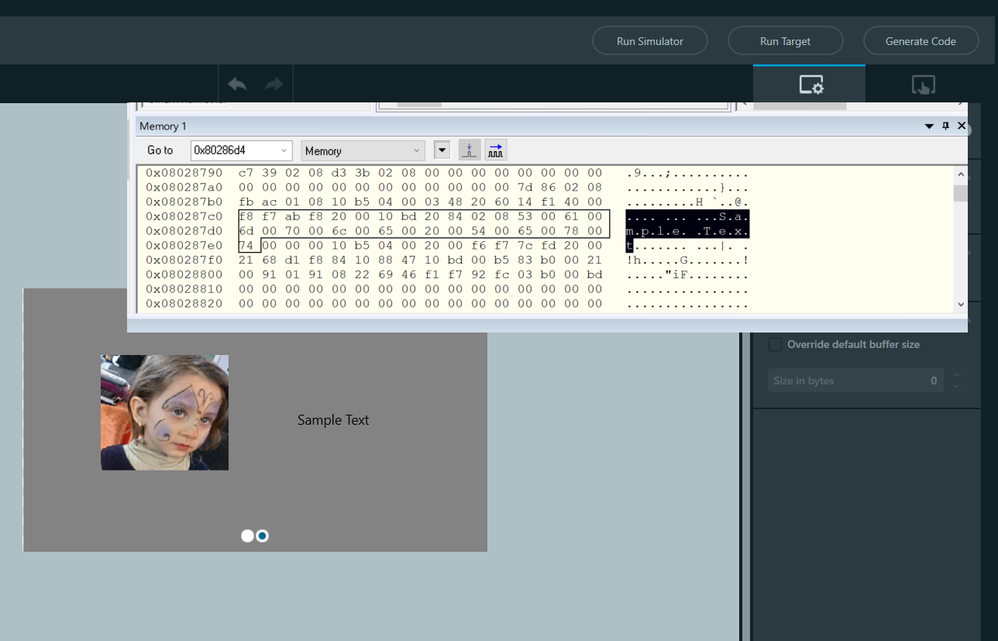

2019-05-08 12:27 AM
I'm sorry for disturbing you. But I couldn't solve my problem.

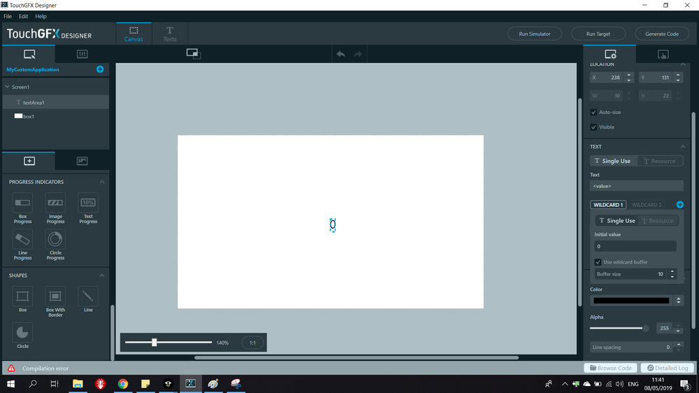

I tried with an alone text on my screen. More details below:
2019-05-08 12:34 AM

In relation to the if statement, i suspect this is to check whether a function pointer (also generated) has been configured for e.g. ligatures in this case. If it has, it is called, but maybe that memory address isn't available or the address is straight up wrong. This could be the cause of the hard fault.

Thanks for your guides. My problem solved and everything works well now. I forgot to set the 'Wildcard Characters' and 'Character Ranges' parameters in the designer!

We were kind of curious about this, so we did some tests. It seems that in some cases, if no wildcard is specified, the text area will try to read some memory that may (in your case also) generate a fault. However, this should never be the case if the code is generated by the designer because even if the application tries to initialize a TextAreaWithWildCard that has no wildcard it will work with a null pointer.
Can you share some information on how you created this application?
