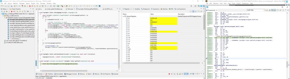

I did find that returning from the function
touchgfx::Unicode::UnicodeChar* touchgfx::Texts::getText(TypedTextId id)
inside Touchgfx/generated/texts/src/Texts.cpp
jump to an odd flash memory address, I don't know if that can be the cause, but before that call all the disassembly steps goes right into pair address.
after that call an instruction "bx lr" jump to an odd address due to the fact that inside the LR register there is an odd address.
The address range is correct and pointing to the right back function .
At the same time the debugger became instable and is more and more difficult to proceed stepping the code.
If left run, the code goes suddenly into an hardfault.
All the function used are from library and/or auto generated code, so it's very strange.
All the text pointer into the external memory seems corrects. I can see the offsett of every string I'm using.
I think to a wrong aligned code but how it can be verifyed ? since the code is precompiled?
