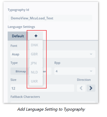

Finally, I would like to ask whether touchgfx designer supports using different fonts for different languages in the font project of the same ID?

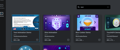

Regarding the typographies for different languages, you can look at the "Text Animation Demo" where we have multiple languages (including Chinese):
but you can also look at this thread where we explain how to add different languages (and font) to a single typography.
