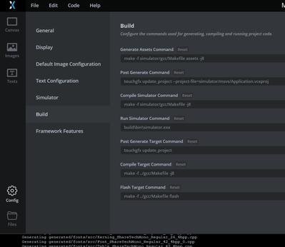

In the build section of the demo named "TouchGFX demo 6", which is exactly the same application running on the kit, there are no instructions to build and upload the demo to the target.
How to solve this? Any hint?

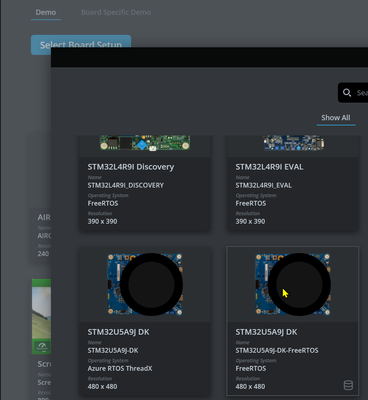

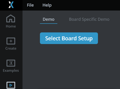

I solved this issue.
You have first to select the matching board setup (so the kit I mentioned)
and then you have reduced set of demos presented for the board.
And here I could select the demo 6 and the build configuration for the target was correctly set then:
Hope it can help someone else.
