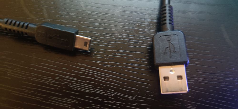

Make sure that you are using USB cables for communicate data (not just for charging).

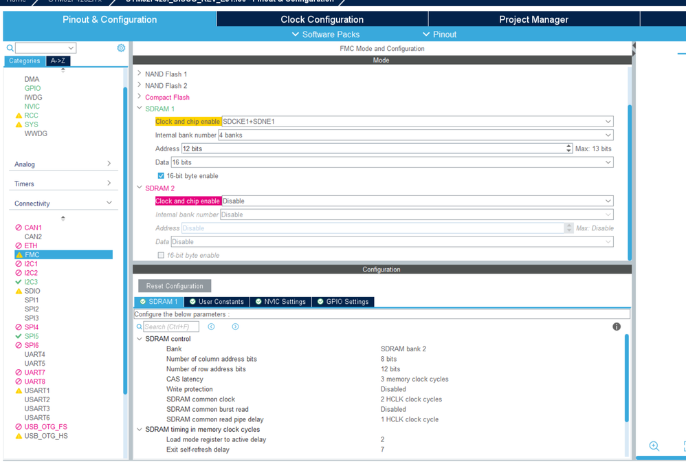

Check Idd jumper. Check DRAM initialization/configuration.

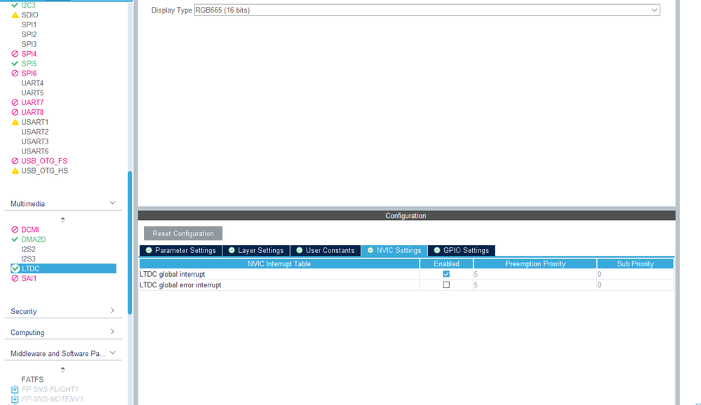

Have you enabled LTDC global interrupt and IRQ?

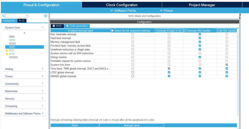

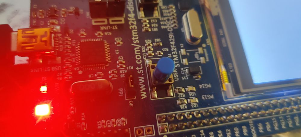

2023-09-26 9:43 AM
Thank you for the reply. I am new to STM32 so there is still a lot of stuff I don't know about so please bear with me. Here is what I have. I have tried two different usb cables and I get the same white screen. By the way, the demos on touchGFX work on my board. Please let me know if you see anything wrong on my options. I have attached pictures below.
