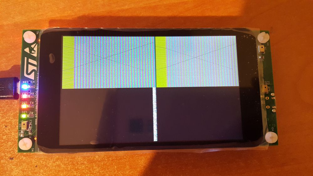

I'm hopelessly trying to configure CubeMX to enableLCD TFT on STM32F469i-disco board (bought recently if that matters). The best effect so far is the following:
What I did:
1. Used CubeMX to generate configuration with all peripherials configured
2. Switched off all I did not need (for instance the RTOS, USART etc.)
3. Selectively copied BSP drivers from the CubeF4 examples. I added all dependencies (components, fonts), such that project builds correctly
4. I try to draw cross through the whole screen, important part of the main.c follows (I stripped comments to improve clarity):
int main(void) { HAL_Init(); SystemClock_Config(); MX_GPIO_Init(); MX_CRC_Init(); MX_DMA2D_Init(); MX_DSIHOST_DSI_Init(); MX_FMC_Init(); MX_I2C1_Init(); MX_I2C2_Init(); MX_LTDC_Init(); MX_QUADSPI_Init(); MX_SAI1_Init(); MX_SDIO_SD_Init(); MX_TIM1_Init(); MX_FATFS_Init(); BSP_SDRAM_Init(); BSP_LCD_InitEx(LCD_ORIENTATION_LANDSCAPE); BSP_LCD_DisplayOn(); BSP_TS_Init(800,480); BSP_LCD_LayerDefaultInit(0, 0xC0000000); BSP_LCD_SelectLayer(0); BSP_LCD_DisplayOn(); BSP_LCD_Clear(LCD_COLOR_DARKCYAN); BSP_LCD_SetTextColor(0x00000000); BSP_LCD_DrawLine(0, 0, 799, 399); BSP_LCD_DrawLine(0, 399, 799, 0); while (1) { } }
This is the best effect I could achieve, at least the lines are visible, but obviously this is not what I'm counting on.
I attached the CubeMX configuration file to this post. I'm kinda new in microcontroller programming (a background with Arduino only), so I have no clue, what might I misconfigured. As the source is really simple, I guess, there's something in CubeMX, that I have misconfigured or not configured, but I'm running out of ideas. I looked at the CubeF4 demos, but they lack CubeMX configuration files. Also, I failed to deduce from the sources, how to configure the LTDC in CubeMX.
I can attach the whole project if needed (though there is nothing more than HAL and BSP copied from F4).
What am I missing? How can I fix the configuration? Is there a place in the Internet that shows how to configure CubeMX for LCD?
#stm32f469-discovery #stm32f469-dsi #lcd2018-06-25 3:51 AM

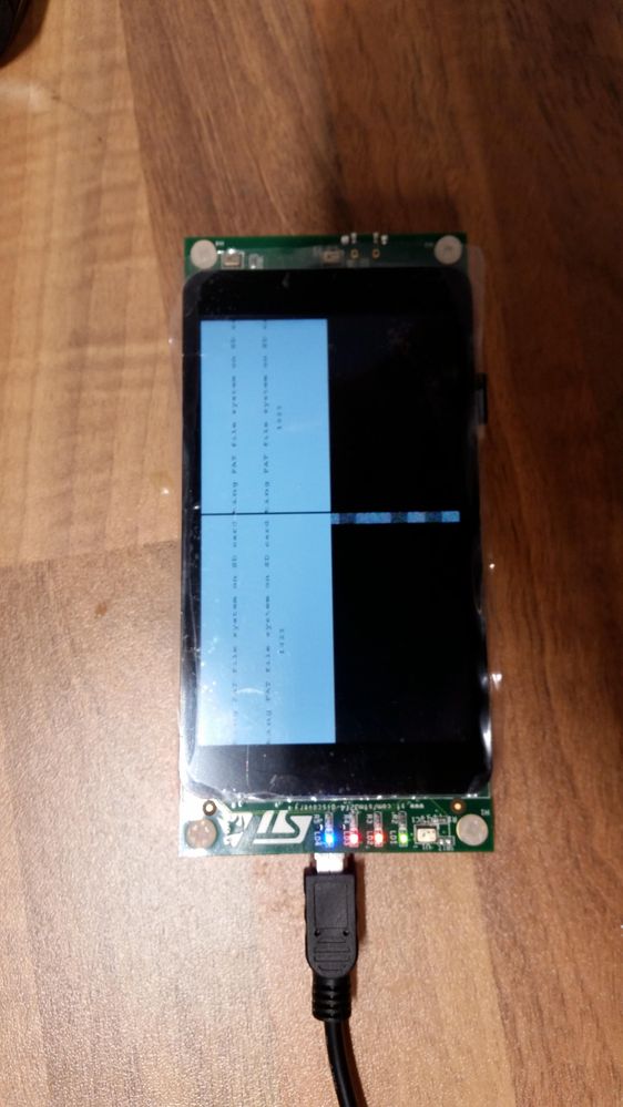

2018-06-25 7:59 AM
I'm having the same issues with the STM32F469I-DISCO and CubeMX-generated code. After setting up all BSP files and getting the project to compile without problemsI got a very similar output on the LCD.The text is a little blurry but readable. I'm also outputting the ADC value on the screen here.
I'm also new to STM32 and lack ideas how to solve this issue. Mybe a clock source is configured incorrectly? This is still a section I left untouched after it was generated by CubeMX, although after verifying it roughly, it should be fine...
Actually the solution to this problem should not be too difficult since all settings for the interfaces and the LCD controller are in the BSP files. Making changes to the LTDC inside Cube doesn't affect anything. Wondering where exactly cube interferes here....Any suggestions would be highly appreciated.
Greetings,
AJ

2018-06-29 8:35 AM
If you try to draw something colorful, you'll notice the same effect as in my case. Try to fill screen with solid color like 0xff0000ff - you will notice, that it cycles through RGB - like the value you chose had invalid size (and someone took like 24 from 32 bits. In this case the flickering also can be easily seen.
It looks like some kind of timing problem for me, though I have no idea on where to seek. I spent some time blindly changing parameters of layers, LTDC, DMA2D, but usually with no effect. Is there anyone at all, who succeeded in configuring the STM32F469I with BSP and LCD? This is really weird, that we independently got stuck in exactly the same situation.

Tried it out. I agree. Looks quite sad
Spent another morning trying to get the thing running, without success. I implemented all the settings for the LTDC and DSIHOST in CUBEMX as well as the clocks as proposed in AN4860 but it didn&39t change much. The displayed text is not readable at all now. The split screen is still there. Just for kicks i set RCC_OscInitStruct.PLL.PLLM = 4 in SystemClock_Config() to 8 and this made the &39split screen&39 go full screen but with not much more.
There&39s this forum topic with somebody sharing a Cubemx project with a partially working LCD with BSP libraries:
https://community.st.com/0D50X00009XkXVRSA3
Unfortunately je Cubemx project file doesn&39t work for me and the Display is offset in the X-direction and flickers a little.
Besides my attempts with setting up a Cubemx project with a working LCD I also tried initializing the necessary peripherals within the examples which is also quite difficult...what a newbie dilemma.
