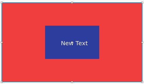

Hello, I have a problem to display the screen on my board, it is always blank white screen. Below is a simple Screen
It shows as a blank white screen on my board, please find attached relevant files lest it is a hardware problem. Please advise.
