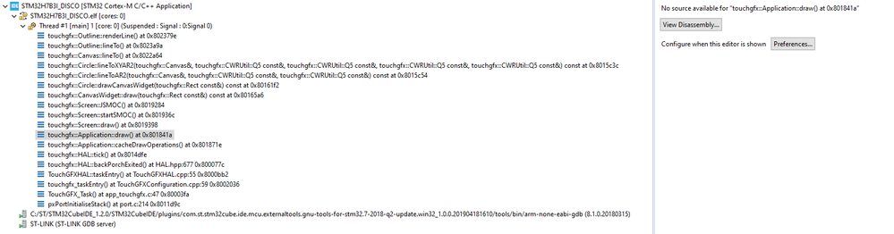

No a fault handler, but if I set in pause the program I'm always blocked into the touchgfx::Outline::renderLine every time. If I play the program and pause again I'm in the same function with a different program counter but closer to the previous one.
I really don't know where I could have done a mistake.
I attach an image of the STM32CubeIde call stack crashTouchGfx
I hope you can help me to figure out the problem, or where I could have made a mistake.

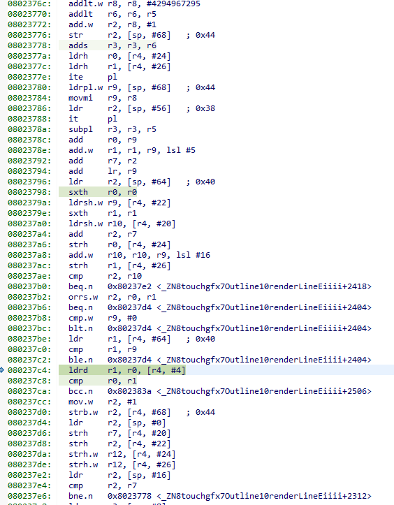

I have checked, the Canvas buffer was 7200... I increased the buffer overriding the size to 32767 as max possible value. The problem still persist the same call stack. No frame are rendered (the blu led of the board is not flashing anymore). The problem happens fast but not in a systematic way. Sometimes the circle is not completly redered, some other time the circle has been drawn for 3-4 times than the operations stop.
I could only place this disassembly. The code continue to run over this lines of code.
