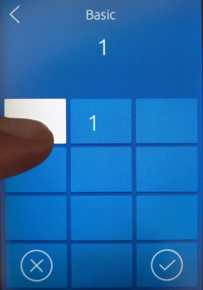

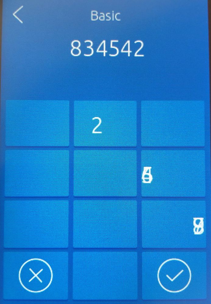

I have a strange problem with my custom keyboard.

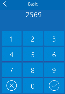

In the simulator everything looks and works fine. See image:

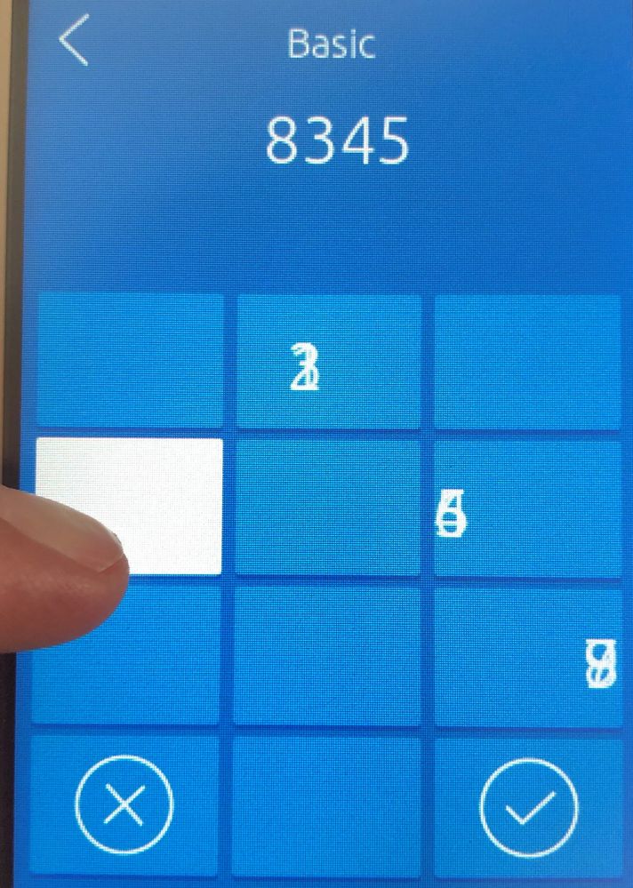

But when I download it to my target, following screen is presented:

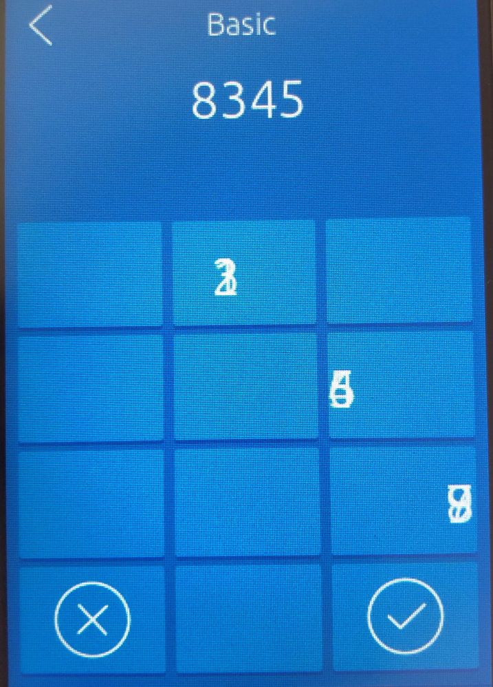

The touch events and the active rectangle are correct and the correct values are shown in the text area. See following image:
When touching e.g number 2, the overlapping numbers disappear. See:
There seems to be a problem with displaying the numbers, the overall functionality seems to work.
Any ideas what's happening here?
Thanks a lot.
/jimmii

The texts are suspiciously offset by what is probably 88 pixels for each row. I think maybe it would be easier if you sent the project. Just for fun, could you try putting in absolute coordinates rather than calculating them?
/Martin

Hey @Martin KJELDSEN
OK, I will try to strip it down.

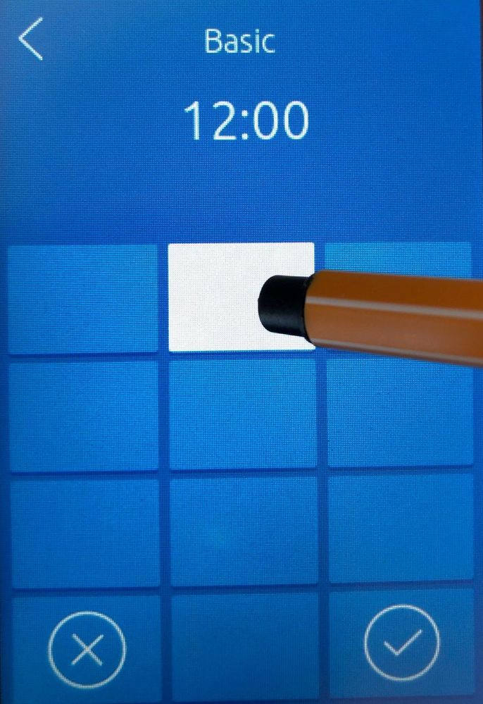

In the meantime I did some tests. I only displayed one digit to keep it simple.
With this code (Button coordinates 0/0)
static const Keyboard::Key keyArray[1] =
{ 1, Rect(0, 0, 82, 62), BITMAP_NUMERICKEYBOARDBUTTON_ID}
}I get this (which is correct, the label is "underneath" the active button):

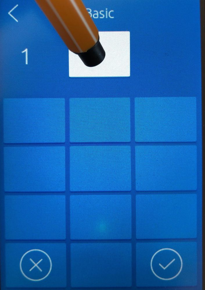

With coordinates (88/0):
{ 1, Rect(88, 0, 82, 62), BITMAP_NUMERICKEYBOARDBUTTON_ID}
}I get: (Button moved correctly in x-position but the label is at the wrong position)

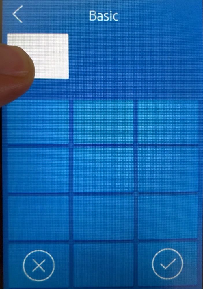

With coordinates (0/88):
{ 1, Rect(0, 88, 82, 62), BITMAP_NUMERICKEYBOARDBUTTON_ID}
}Again, the button moved correctly in y-position, the label also moved but at the wrong position.
With coordinates (88/88):
{ 1, Rect(88, 88, 82, 62), BITMAP_NUMERICKEYBOARDBUTTON_ID}
}The button and the label are at the correct position (label underneath the active button)
It seems as the label corrdinates are not translated correctly. I'm using the display in portrait mode. Is there a difference as how the simulator translates the coordinates in comparison to the "target" code?
Maybe you can reproduce this with the sample keyboard code (I also took that code and adapted it to my requirements)
In the meantime I will provide the code for you.
Thanks a lot.
/jimmii
