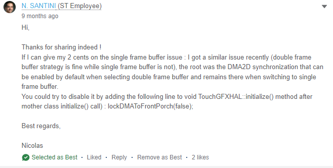

I had a problem with the single buffer option. My setup was random SPI TFT display and NUCLEO board. Solved it with the following answer:
2022-01-26 4:21 AM
lockDMAToFrontPorch is false by default in later versions. It didn't used to be that way which could cause some problems if the Display interrupt never reported when the front porch had been reached.
