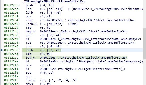

2020-05-27 8:39 AM
Single buffering gets stuck in HAL::LockFrameBuffer. You mentioned there are only two function calls in there and they're only used in the single buffer case:
dma.isDmaQueueEmpty();
dma.getAllowed();When I stop the debugger, it appears FreeRTOS is still operating normally (eg. no crashes or anything), but the call to HAL::LockFrameBuffer is permanently stuck in a loop. The disassembly below shows the relevant lines highlighted in green. These 3 lines just execute in a cycle repeatedly.
Thanks!
Eric

2021-02-02 3:14 PM
I can confirm that I have the same behavior. Works with double buffering but fails on unlocking buffer when single buffer is used. Can we get confirmation that this is a bug and if it is or isn't being looked at?
2021-04-26 1:38 AM
Same behavior here. Engine stucks with single buffering strategy option enabled in CubeMX. Only double buffering works.
