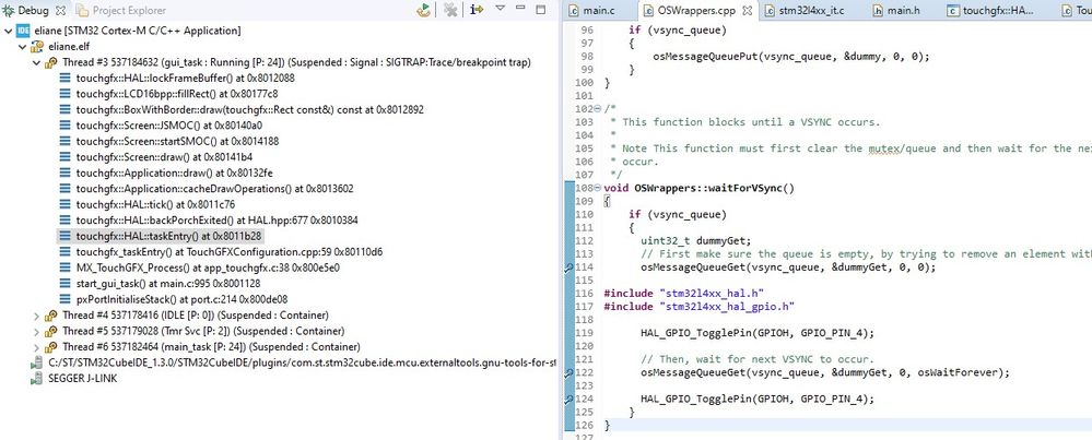

I've verified that the vsync signal is definitely being added to the queue. It also appears that both osMessageQueueGet() calls in waitForVSync() are succeeding. I've confirmed this by adding LED toggles surrounding them. However, after that GUI appears to get stuck at lockFrameBuffer(). I assume this function is implemented in libtouchgfx.a because there is no source available for it.

I added breakpoints in OSWrappers::takeFrameBufferSemaphore() (as well as OSWrappers::tryTakeFrameBufferSemaphore() for good measure) but neither of them is reached. It appears that lockFrameBuffer gets hung up before calling them.

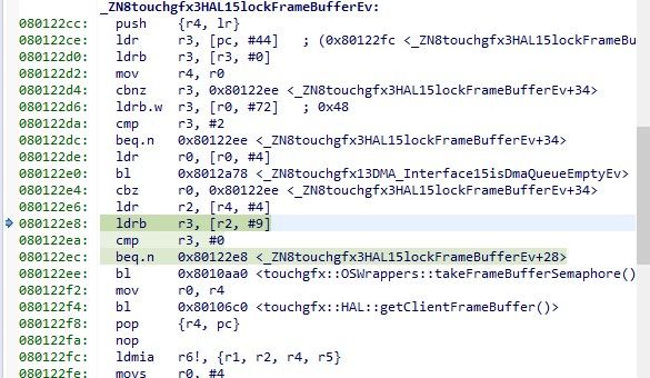

Single Buffering: This still does not work. The fix for Double Buffering does not seem to have any impact. The program continues to execute but the GUI task is stuck in HAL::lockFrameBuffer() and never returns. There is no source available for this function but this is what the disassembly shows:
Execution stays inside the 3 highlighted lines.
Could you please help me sort out what is going wrong here? Using double buffering isn't really a viable option as it consumes all of the available RAM.
