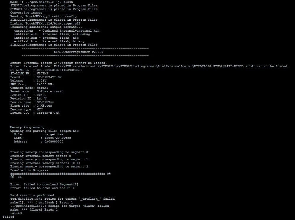

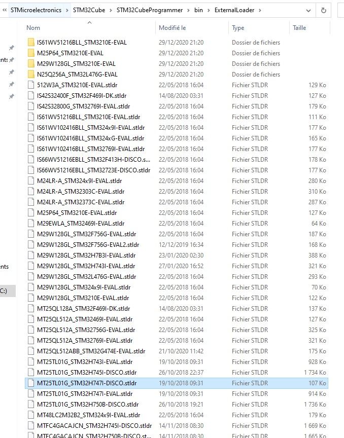

I have a STM32H747I-DISCO and I am trying to use it with TouchGFX in the first part. But the problem is I cannot use it directly with TouchGFX "Run Target" mode.
I have few errors, I tried to run as admin but it didn't work. I have the external loader file specified.
Could you help me please ?

2020-12-29 2:21 PM
Use version 2.5.0 of the tool
2020-12-29 2:21 PM
2020-12-29 2:56 PM
Thanks for your reply, I tried the 2.5.0 version (2.6.0 before) and now it works.
Thank you.
