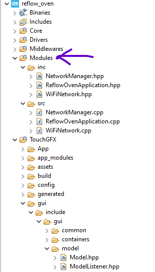

Hello, i have some c++ classes in a separate folder called Modules (in the project root directory). I added the header and source files in the Modules folder to the Makefile in TouchGFX/simulator/gcc but will not compile successfully.
The image below shows the location of the Modules directory

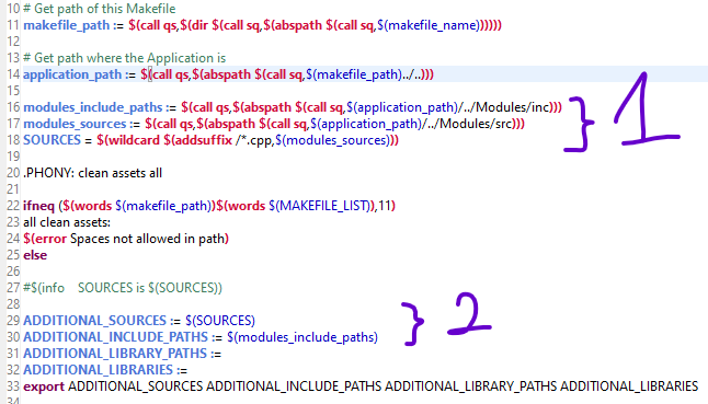

The image below shows the added Modules source and header to the makefile.

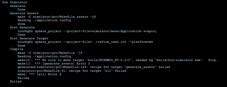

The image below shows the Simulator compile error

In generated makefile exist linees
source_files := $(call find, $(source_paths),*.cpp) $(framework_files) $(ADDITIONAL_SOURCES)
c_source_files := $(call find, $(source_paths),*.c)then your add works only for cpp files.
And im not expert for make , but why you create new vars and not use ADDITIONAL_SOURCES directly?
