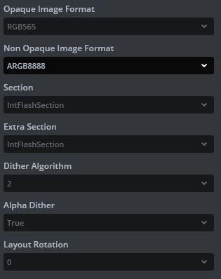

I read the topic about L8 images, but I don't use this type of image. I'm using RGB565 and ARGB8888 image formats as seen in the picture.
Can someone help me to find why this widgets causing hard fault in my app?
