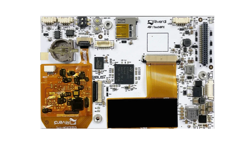

Image source: https://riverdi.com/product/5-inch-lcd-display-capacitive-touch-panel-optical-bonding-uxtouch-stm32u5-rvt50hqsnwc00-b

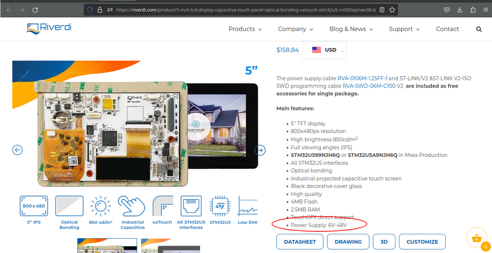

I'm not sure this is very clear, as it is announced as Power Supply: 6V-48V.
Interesting that these recommended IC drivers are for low V. input:
Even HD44780 LCD are coming with built-in limiters. At $160, at least the driver could have been included :money_with_wings:

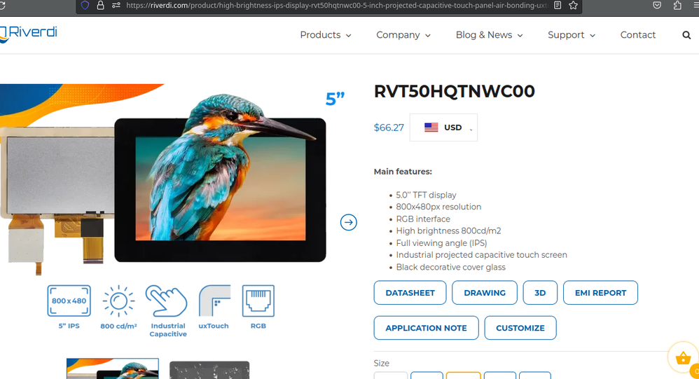

@RhSilicon Uhm… you accidentally mixed up:
Yeah, a single letter (T vs S) and it's a completely different device. Display manufacturers tick a little differently than semiconductor manufacturers...
2023-08-14 12:15 PM
That's really it, the letter T in the middle of the code. Value of $66 is more acceptable (a little expensive decorative cover glass, compared to other similar model, $22).
