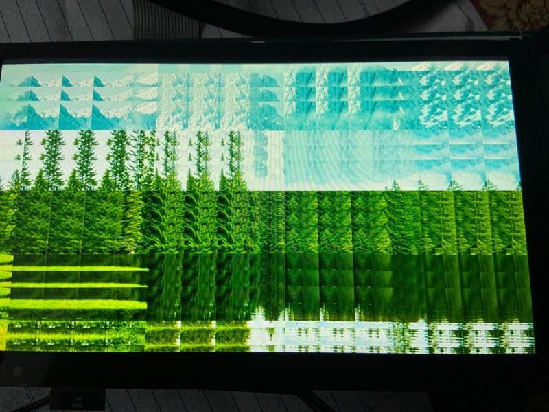

I’m working with a custom 24-bit display on an STM32H757XIH6 MCU.
I’ve configured the LTDC with pixel format ARGB8888.
When I test with solid fill colors, everything displays perfectly.
However, when I try to display an image using TouchGFX Designer, the output appears as repeated, tiled, and shifted blocks instead of the correct image.
I’ve attached a photo of the display for reference.
Has anyone faced this issue before, or could guide me on how to resolve it please
Thank you in Advanceshifted blocks

The issue was related to the SDRAM clock, but it's been resolved now.
Thanks @LouisB

Hello @rahulz916,
Have you check the rest of the configuration according to your screens specs? (In the CubeMX LTDC panel)
BR,
2025-09-15 2:23 AM
Thanks @LouisB
