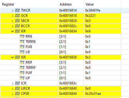

I did found that I wasn't enabling LTDC and DMA interrupts during HAL_LTDC_MspInit and HAL_DMA2D_MspInit. I enabled them but I keep having the same problem of running on a Infinite Loop.

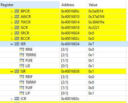

I notice now that my program is going to default handler after GPIO::init() under GRAPHICS_HW_Init. Checking the ISR of LTDC I noticed that I'm having FIFO underrun Interrupt flag.
I found this article: https://touchgfx.zendesk.com/hc/en-us/articles/205676691-Debugging-Pixel-Error-Issues that refers to a similar error. I've tried to reduce the LTDC clock by a factor of 4 and my code progress a little and stops again on a infinite loop but now the ISR indicates an Line Interrupt Flag.
