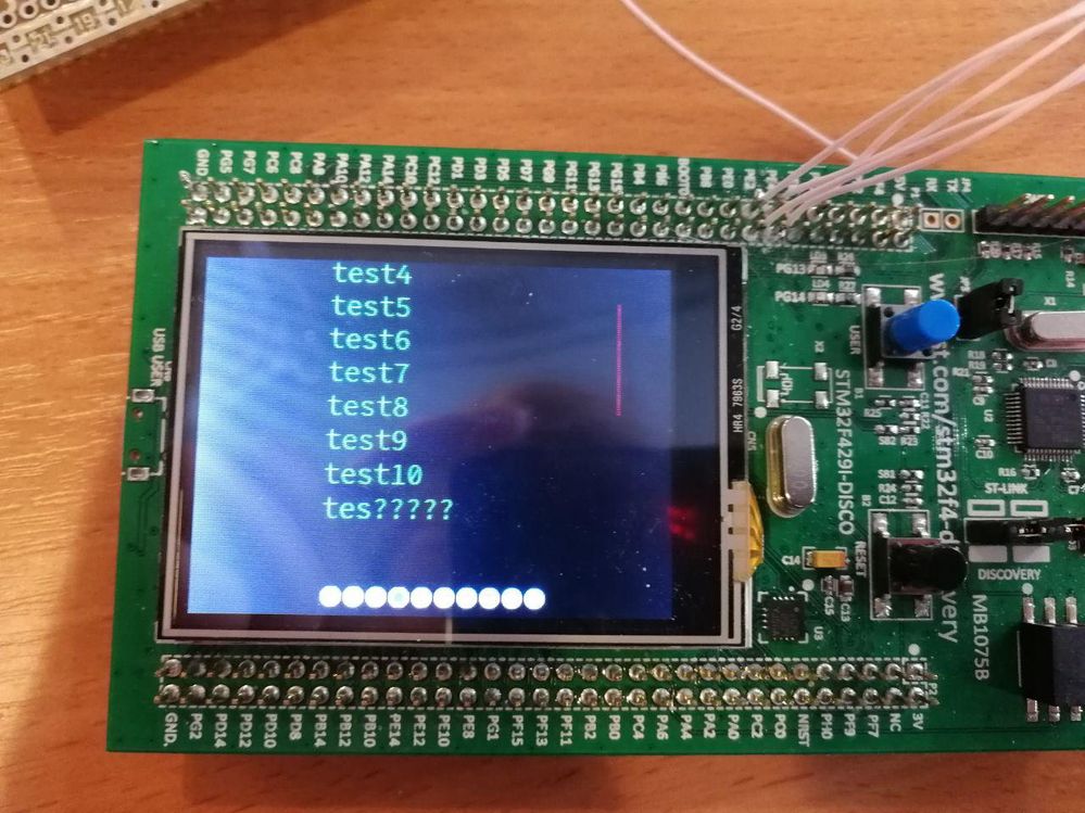

2019-06-21 5:48 AM
Hello Martin,
I have a problem, it works well when I scroll the text, which I wrote in TouchGFX Designer,
but when I change the text for this one:
Unicode::snprintf(textArea1Buffer, 600, "test1\ntest2\ntest3\ntest4\ntest5\ntest6\ntest7\ntest8\ntest9\ntest10\ntest11\ntest12\ntest13\ntest14\n");
textArea1.invalidate();I can scroll some lines, but then I get:
How could I resolve the problem?
Anton
