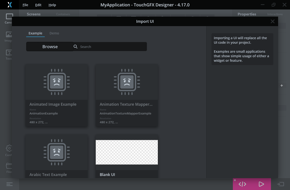

Yes in new empty project open Import GUI and BROWSE to existed ***.touchgfx file.
