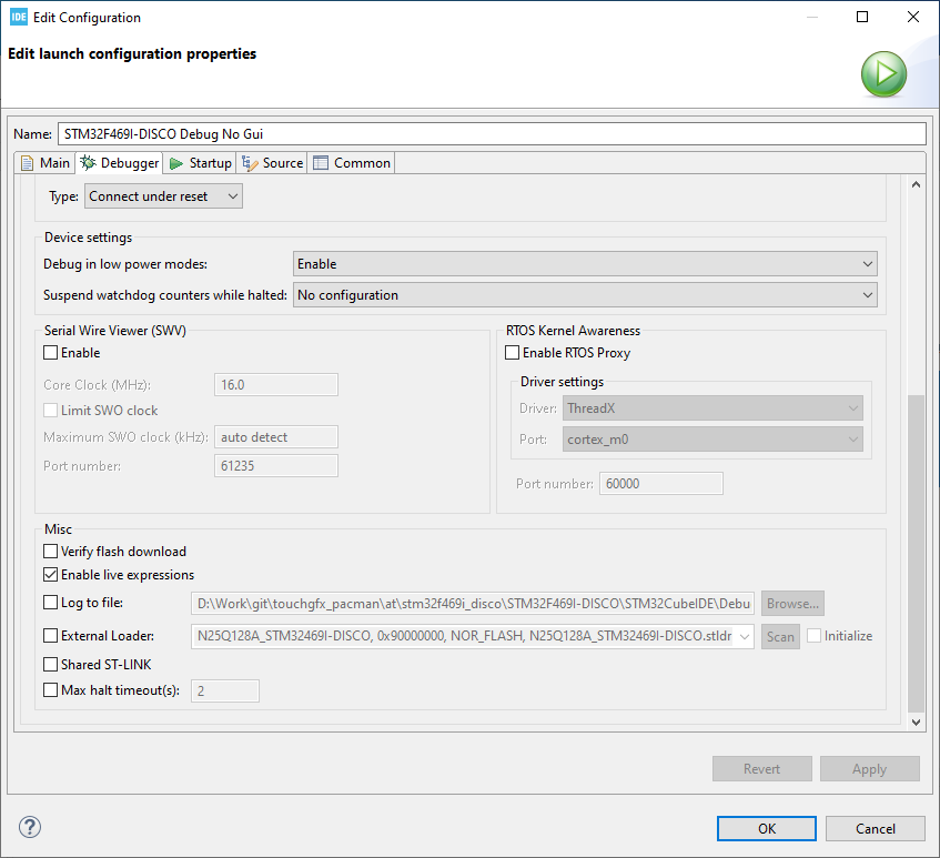

The best way to do this is to create a new launch configuration in your Run/Debug settings. In addition to my Debug configuration, I have a similar one called Debug No GUI. In this configuration, you go to the Debugger tab and uncheck the External Loader Checkbox in the Misc group (you need to scroll down to see it).
Another nice thing you can do is if you want to run the debugger in low power modes, you can Enable that in the Device Settings group on the same dialog. I actually have 4 debugging configurations:
GUI with LPM
GUI wo LPM
No GUI with LPM
No GUI wo LPM
If I have changed anything in the GUI, I simply select my 'GUI wo LPM' Launch Configuration.
