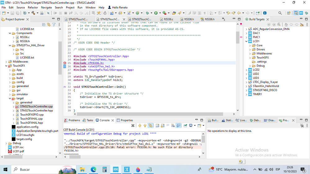

I can configurate the touchGFX configurator with the stm32f746, i can open the .part and designer some figures and bottoms, these yes appears in the LCD, i use the hardware stm32f746 discoveryboard.
But i no can active the function of the touch, have activate the I2C3 with 100khz, standard mode, as examples use the GFX Designer, but i no find put the FT5336 driver, or how i can configurete o call a these file autmatically ? i no understad how active the touch controller,

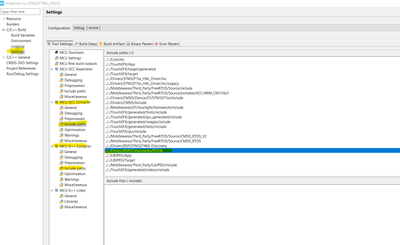

Hello @RMasi.19 ,
Did you include the path of your ft5336 driver?

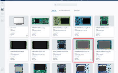

Hello @RMasi.19 ,
If you use an STM32F746G-Discovery board, we already provide a TBS that you can use without changing the driver or anything to enable touch screen.
Have you tried it?
2023-10-10 6:47 AM
Hi, yes i have probed the stm32F746 discovery kit, but i want practice with touchGFX generator and take the discoveryboard as if it were my design, i can generate images but the touch no work

2023-10-11 1:13 AM
Hello @RMasi.19 ,
2023-10-11 6:24 PM
Thank you, i can now activate the touch with touchgfx generator,

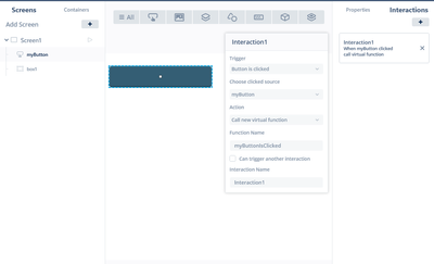

Hello @RMasi.19 ,
I don't understand why you need a condition for your button. You just need to declare an interaction with as trigger : "Button is Clicked". Like this :
Then you can code that function in your Screen1View.cpp
void Screen1View::myButtonIsClicked()
HAL_GPIO_WritePin(GPIOI, GPIO_PIN_1, GPIO_PIN_SET);
I think it's simpler like that. Could you try that and tell us?
