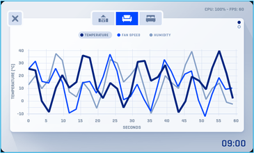

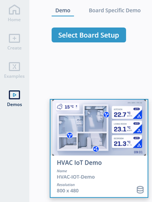

I am not sure I fully understand all the details of your request, but in general, I would recommend taking a look at the Graph screen in the HVAC Demo, which is available in TouchGFX Designer:
Here, three graphs are shown concurrently, with one of them highlighted. The labels are created using text areas to make them more flexible and versatile.
Please let me know if there are any specific features you still cannot get to work after reviewing the demo.
