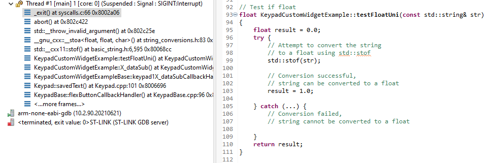

is C++ handle exception included in TouchGFX release ?
I did not manage with the code here below, testing a string for a float with std::stof. (TouchGFX 4.21.4)
Thanks

Hello @JJame.1 ,
Exceptions can be use in your project's code but are not handled by default, and the TouchGfx library is not compiled with exceptions.
Can you tell me which ToolChain you are using?

Hi Louis,
I use GCC but I found a solution using sscanf from this post : https://community.st.com/t5/stm32-mcus-products/floating-point-support-in-sscanf/td-p/429726
