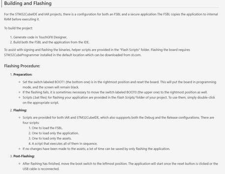

For the STM32N6570-DK, we advise our users to use the provided script that is intended for flashing. You'll find more explanation about the flashing procedure in the readme file (located in your project root folder), but in your case, this part is the most important :
We will release soon another version for this STM32N6570-DK TBS where you can flash directly through TouchGFX Designer like all the other TBSs.

Hello @Duc ,

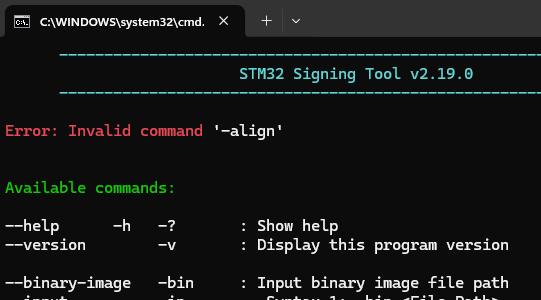

Hi Osman,
I have the same problem: I cannot run the created Two Screens App (shows Screen1 or Screen 2) from TouchGFX on the STM32N6570-DK board. The generated scripts also do not help. When they try to sign the *.bin file then the STM32_SigningTool_CLI.exe stops with Error: Invalid command '-align'.
In the available commands there is no -align command. Do I have a wrong version of the signing app?

2026-03-08 4:03 PM
Hello @Louie88 ,
I confirm that the issue is the use of an outdated version of STM32CubeProgrammer. Updating to the latest version should fix the issue.
