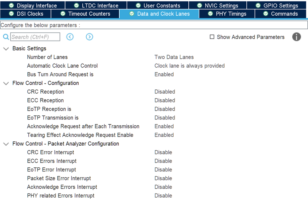

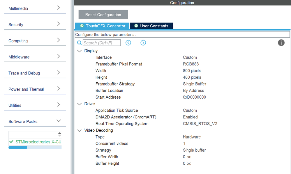

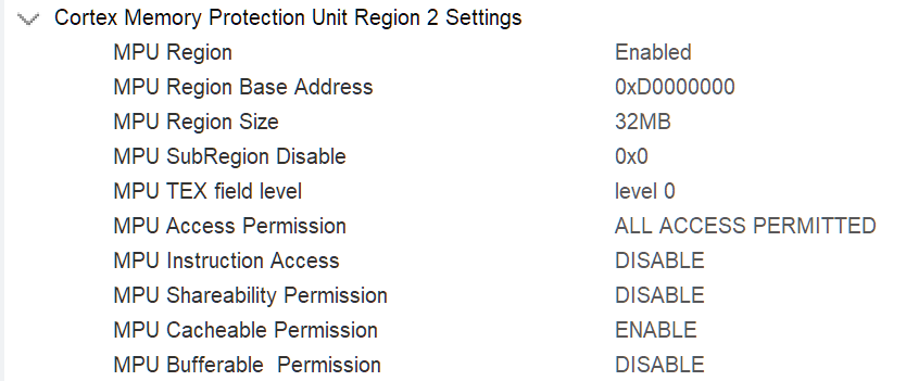

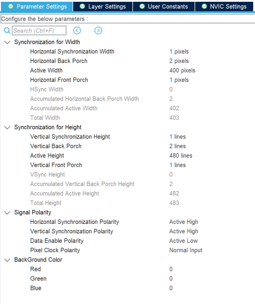

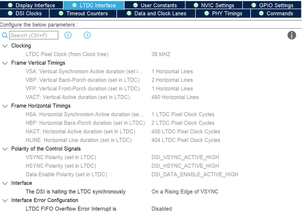

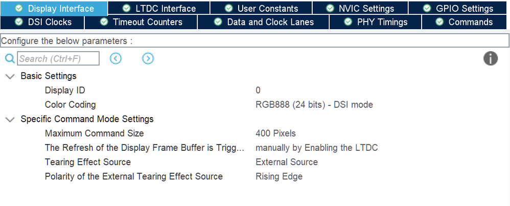

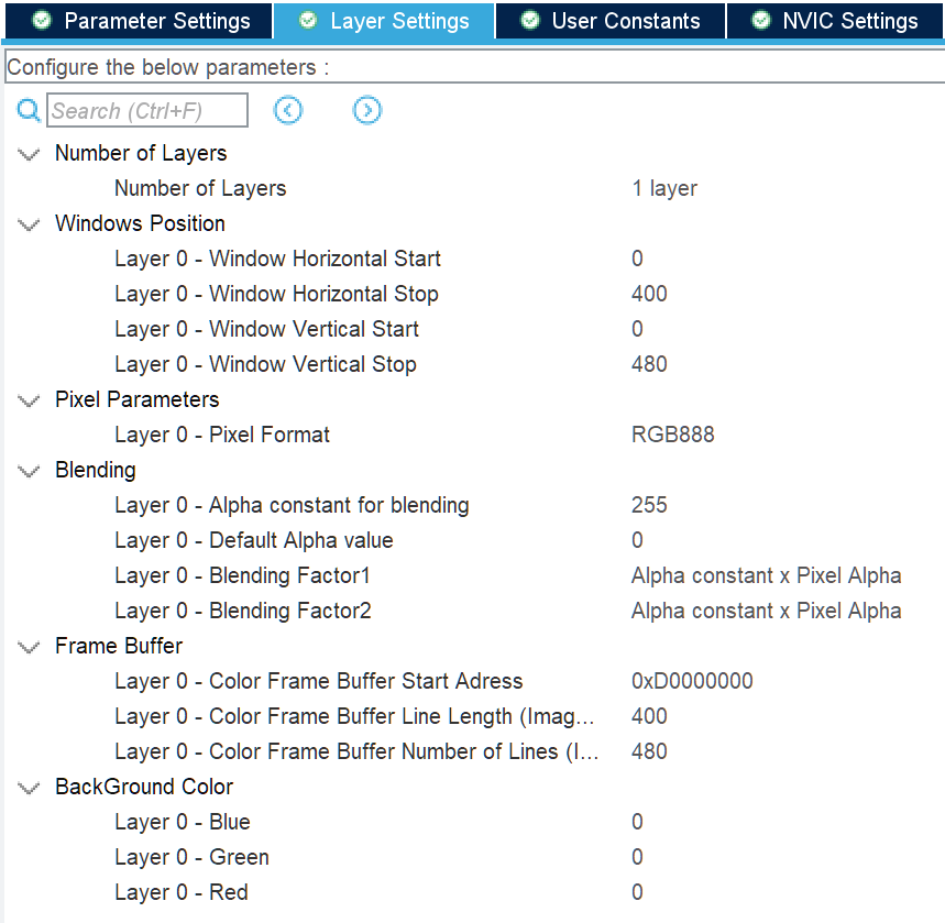

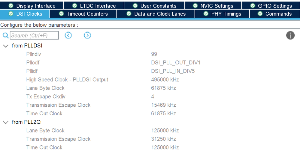

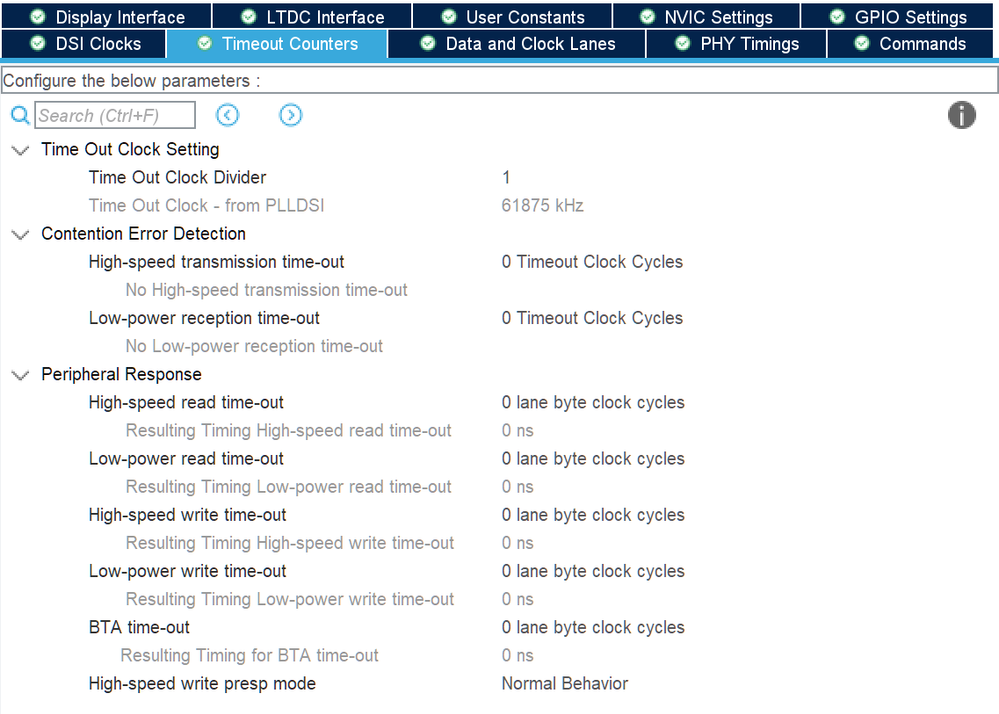

Of course, here it goes:
The configuration presented is for single buffer, because when I switch to double buffer my application crashes.
My current code uses followin user code initialization:
/* USER CODE BEGIN initialize step 2 */
setAnimationStorage((void*)0xD0180000); // right after frame buffer, to enable slide transitions.
HAL::getInstance()->setFrameRateCompensation(true); // to make slide transitions blazing fast.
lockDMAToFrontPorch(false);
mcuInstr.init();
setMCUInstrumentation(&mcuInstr);
enableMCULoadCalculation(true);
/* USER CODE END initialize step 2 */For double buffer I used address 0xD0300000 for the animation storage, 0xD0180000 was the second frame buffer address.
