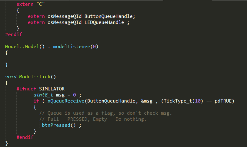

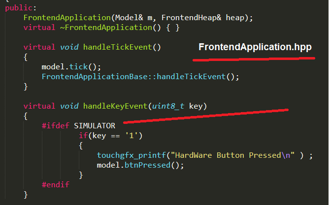

2020-04-27 9:08 PM
@Martin KJELDSEN (ST Employee) Thanks for update ..
The below code without TouchGFX Works well..
while(1)
if ( HAL_GPIO_ReadPin (BUTTON_GPIO_Port, BUTTON_Pin) == GPIO_PIN_SET )
HAL_GPIO_TogglePin(LED_GPIO_Port , LED_Pin) ;
HAL_Delay(300) ;
printf("HELLO \r\n") ;
}But Code worked on simulator Updating TextArea WildCard Perfectly ..
I have made some changes/correction in code attached at Msg #1.
After doing some experiments cause to Fault Situations.
( xQueueReceive(ButtonQueueHandle, &msg , (TickType_t)10) == pdTRUE)
Please Find updated files as works on simulator and touchgfx simulated short video..
as below method.. as per you webinar "Integratiing UI and Hardware"
Please Find attachment ..
Karan

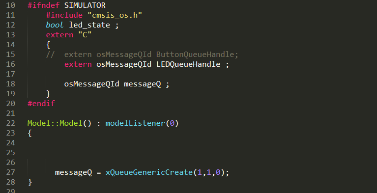

I think there is an error in your model.cpp
I'm referring to my own example in this video: https://www.youtube.com/watch?v=majcfxr3u2E
The model looks something like this:
extern "C"
xQueueHandle messageQ;
Model::Model() : modelListener(0)
messageQ = xQueueGenericCreate(1,1,0);
}So I can see two things different in your setup:
Lastly you wait 10 ticks for your messages. I don't think that it is needed or it helps anything. I can't recall if the waiting is a blocking call or not. If it is you have reduced your framerate a bit.

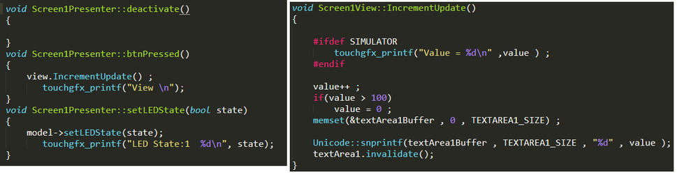

2020-04-28 10:26 AM
well, I didn't use a button but I did use a queue. your button sampling code looks fine.
Did you try and change the code with my suggestions?
The simulator and hardware is similar but not completely similar so there's a pitfall.
Looking at your model..
walk through it with me.. if you get a message you call btnPressed()
Inside that method you do what? I think you intend to call the 'IncrementUpdate' method in the presenter, but you don't. you call the btnPressed() again? is that right?

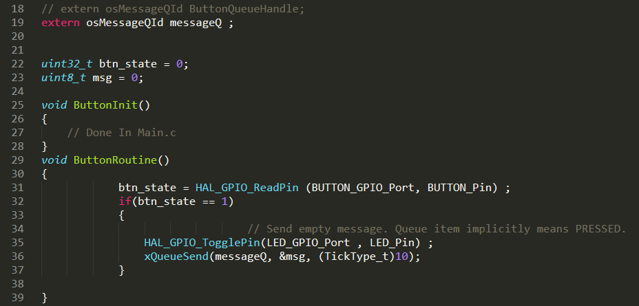

2020-04-28 10:48 AM
Here are Code snapshots..
Please check updated One
The I did also use xQueueReceive(LEDQueueHandle , &led_msg , 0) worked well on Hardware LED in same (this) application ..
My ADC , UART code working fine with Semaphore (without Queue).
I will check your code suggestion tomorrow.
Thanks
Karan
2020-04-29 1:38 AM
@HP (Community Member)
This method works.. Thanks for that ...
1) Is it mandatory to create "Queue" inside the Model::Model() in Model.c ?
2) If Yes, Why cmsis syntax complied but same HardFault ...
osMessageQDef(ButtonQueue, 1, uint16_t);
ButtonQueueHandle = osMessageCreate(osMessageQ(ButtonQueue), NULL);
Or Any other Issue .. Please Update..
Any Way Thanks..
Karan
