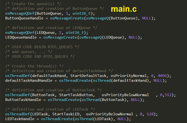

I am trying to do send/receive messages with Message Queues.
1) From TouchGFX Toggle Button to LED.
2) From Hardware Button to Text Area
as per below thread.
Program Successfully Build . But Still not succeeded to Work on Actual Hardware.
LED is not OFF/ON with TouchGFX Toggle Button
2) From Hardware Button to Text Area Update
HardFault and/or MemManage_Handler
Because I have changed priorities and Heap .
Can anybody look attachment ? Guide me What needs to be correct ?
To solve the problem .

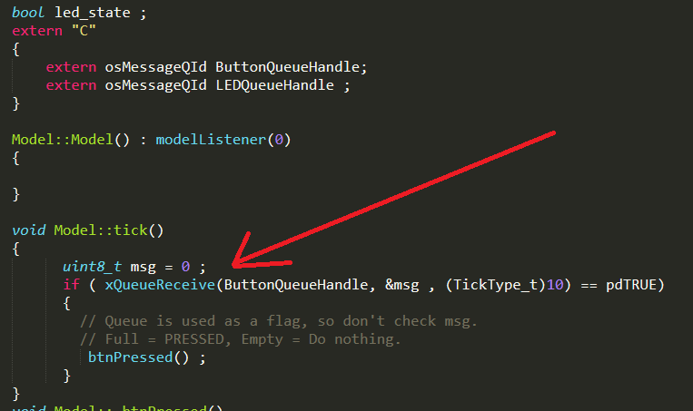

2020-04-28 9:54 AM
I think there is an error in your model.cpp
I'm referring to my own example in this video: https://www.youtube.com/watch?v=majcfxr3u2E
The model looks something like this:
extern "C"
xQueueHandle messageQ;
Model::Model() : modelListener(0)
messageQ = xQueueGenericCreate(1,1,0);
}So I can see two things different in your setup:
Lastly you wait 10 ticks for your messages. I don't think that it is needed or it helps anything. I can't recall if the waiting is a blocking call or not. If it is you have reduced your framerate a bit.

2020-04-27 4:03 AM
After doing some experiment , I found with
if ( xQueueReceive(ButtonQueueHandle, &msg , (TickType_t)10) == pdTRUE)
// Queue is used as a flag, so don't check msg.
// Full = PRESSED, Empty = Do nothing.
btnPressed() ;
Cause HardFault or MemFault..
And Queue is created in main.c and not in Modal.c inside the Model::Model().
Karan

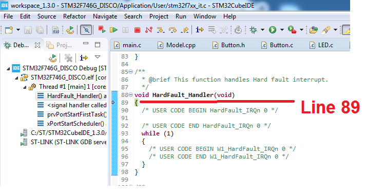

2020-04-27 4:10 AM
Which line causes a hardfault? What does btnPressed() do? Later versions of EWARM have the ability to tell you the offending instruction following a hard fault
/Martin
2020-04-27 4:34 AM
@Martin KJELDSEN (ST Employee)
Thanks for Update ..
1) When I Button Hardware Button HardFault Occurs.
2) When I TouchGFX Toggle NO Response from LED .
3) I am using STM32CubeIDE 1.3.0 .
Can you review my extracted code as attached Msg #1 .. ?
Karan

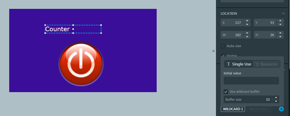

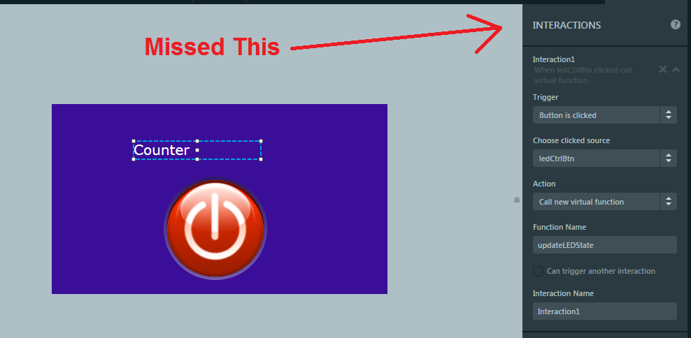

2020-04-27 6:36 AM
1) When I used Toggle Button from TouchGFX - LED ON , OFF Worked
Actually, I missed interaction part from your webinar.
2) When I pressed HardButton - HardFault Still Occurs.
(Hardware Button Just Increment the value in TextArea WildCard )
Can you review my extracted code as attached Msg #1 .. ? Do I need to set / Increase total stacksize in the RTOS config ?
Thanks
Karan
2020-04-27 8:00 AM
When I pressed Hardware Button - Hard Fault Still presists.
(Hardware Button - Just Increments the value in TextArea WildCard )
But Code worked on simulator Updating TextArea WildCard Perfectly ..
I have made some changes/correction in code attached at Msg #1.
Is there any issue in code or bug..? Specifically Below line responsible Hard Fault or Memory Fault.
btnPressed() ;
Karan
