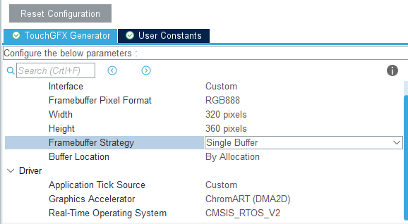

<TouchGFX configuration in ioc file>

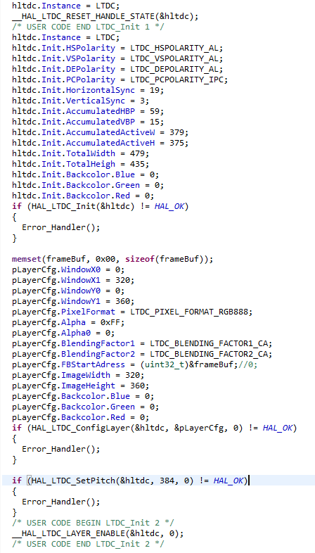

<MX_LTDC_INIT() function in main.c file>

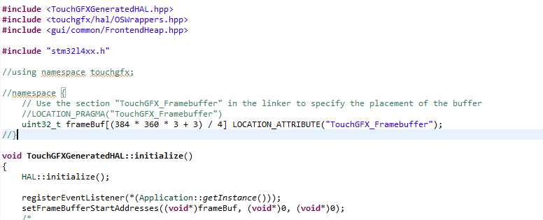

<TouchGFXGeneratedHAL.cpp file - for buffer declaration point>

I see primary trouble , that you set Custom drivers. When you use DSI with full framebuffer, you need set LTDC not Custom.
2021-02-08 4:22 PM

Thanks for your experienced reply, MM..1.
Actually it was the point I didn't consider at all before.
I will try to change the Display Interface from Custom to Parallel RGB(LTDC) as you suggested, and let you know about the result.
2021-02-08 5:59 PM
Hi MM..1,
I tried your suggestion, but there was no change.
It seems it makes changes on TouchGFXGeneratedHAL.cpp side, such as lcd_int_active_line/lcd_int_porch_line and new callback as 'HAL_LTDC_LineEventCallback'. But it seems this callback is never called. Do we need to setup additional configuration to make this callback work?

For whom who will need this information later, let me update on this.
I finally needed two changes to correctly display my TouchGFX resources.
As I was using the original version from STM32L4R9I EVAL board, it was defined based on GFXMMU dependent buffer width(3072/2).
The definition goes like BSP_LCD_IMAGE_WIDTH -> GUI_FRAME_BUFFER_WIDTH -> FRAME_BUFFER_WIDTH, finally.
After correcting the width as the one considering DMA2D transfer width, I can see outputs from TouchGFX delivered by DMA2D finally.
