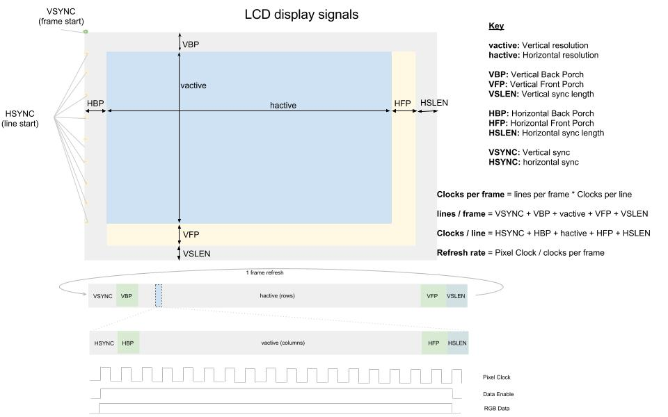

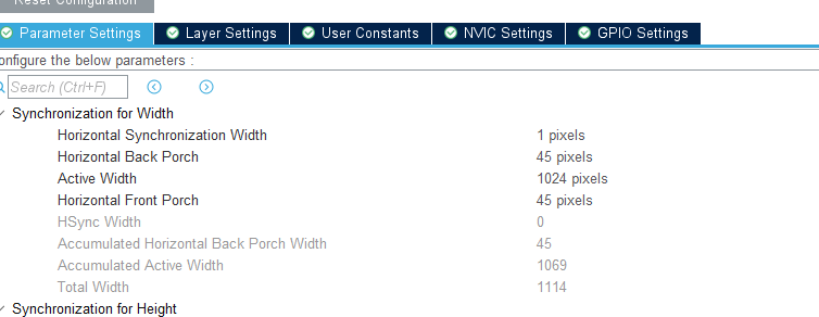

You can increase the front and back porches in your LTDC.
This way you use more LTDC clock cycles per frame so your frame rate drops.

Increase your porch sizes.

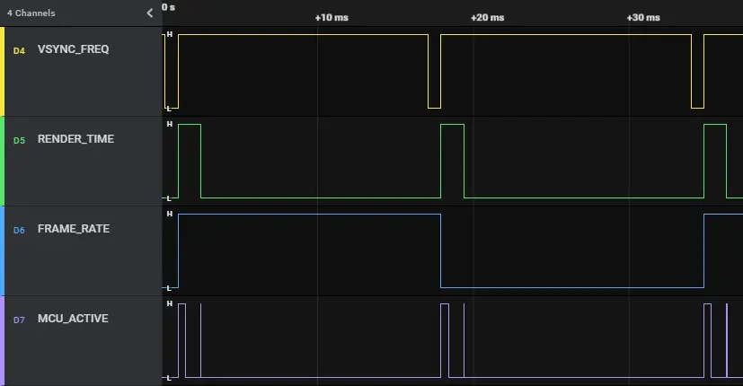

 The CPU is not busy waiting (blocking) for LTDC interrupts. You'll actually get more idle time per frame.
https://support.touchgfx.com/docs/development/touchgfx-hal-development/scenarios/scenarios-measure-performance#performance-metrics
