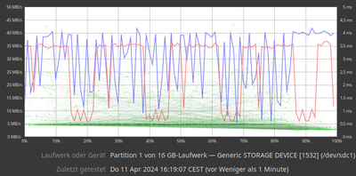

this is R/W test from a 16 GB Transcend card, about 1 year in use:
Transfer/Interface speed is always about 400Mbit here, so all dips are some delay, until data coming.
And on a STM32 you have no (native) UHS mode, so ... i got max. 8MB/s effective read speed.

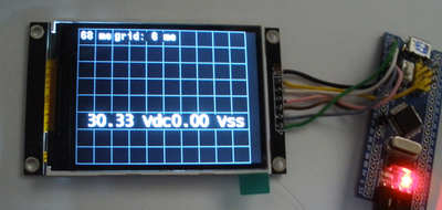

for small TFT , maybe 3" , 320x240 pix , i use only SPI ;
speed with an F303 at 18 Mbit on spi to TFT , for full screen write ("cls") is 68 ms , but 6 ms with DMA->SPI (but overclocked at destruction limit - so just a funny test ; display did stop working some seconds after this.
(But recovered some minutes later. So better dont try too much overclocking.)
