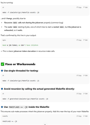

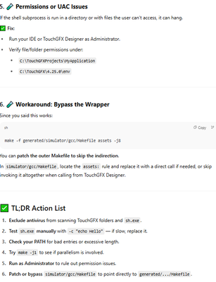

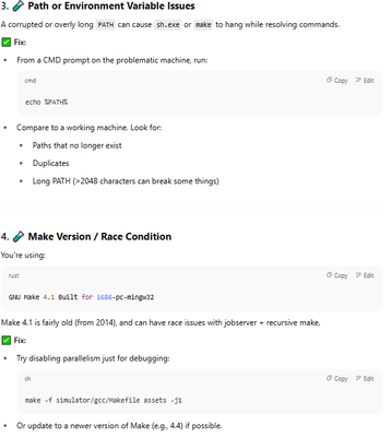

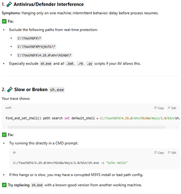

I asked GPT
2025-07-24 1:32 AM
2025-07-24 1:35 AM
